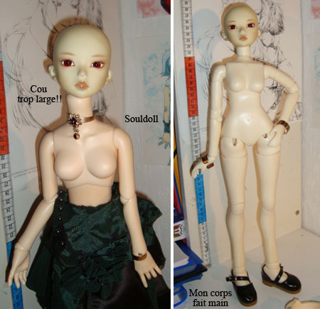

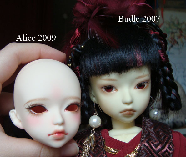

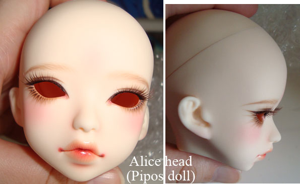

Here all information about my Pipos doll budle (2007), the same mold as Alice:
standing , face , profile.
Resin is yellow, it wa s yellow since the beginning.

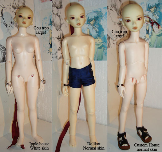

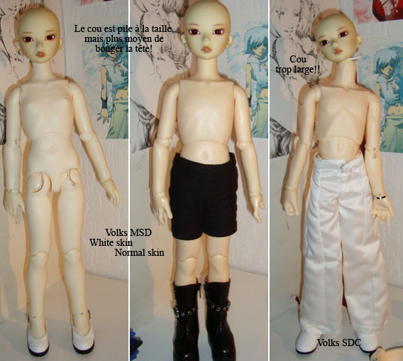

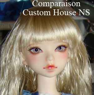

Hybridation try
Necks of custom house little junior and iple house are too large!
Volks MSD fits perfectly... but head can't move. Volks SDC neck is far too large.
neck of Soulkid body is too large

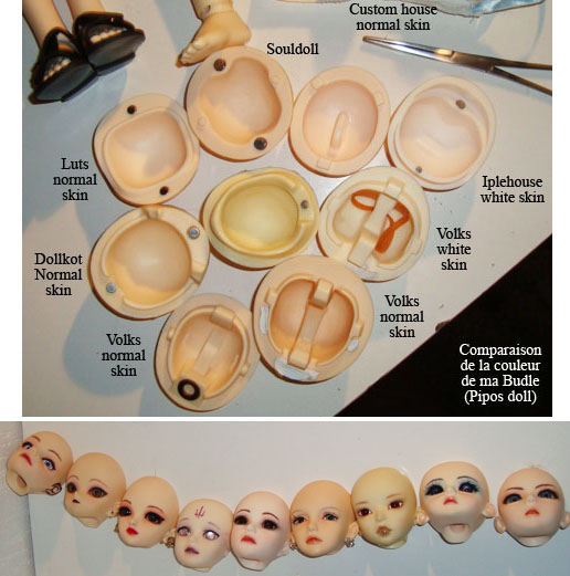

Comparisons of color and heads
I don't have any Dollmore, Minifee, Unoa, Serendipity.... to try other hybridations.
latedate_kate: My budle has her own hand-maid body, it is very slim and yellow, to fit the head color. (picture here, warning Nudity)

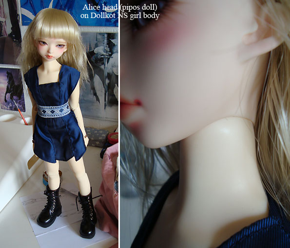

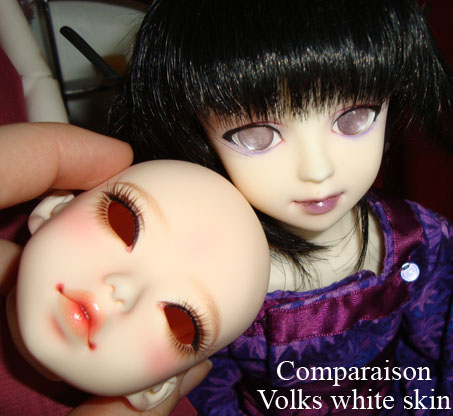

Here the first pictures and tries! The head comes without eyes, just the head in a pink carton box^^ I have compare the head with Luts normal skin too (but no picture), almost the same color. I have tried the head on a Dolkot body NS too. Dolkot is more yellow, but proportions are fine. Picture later.

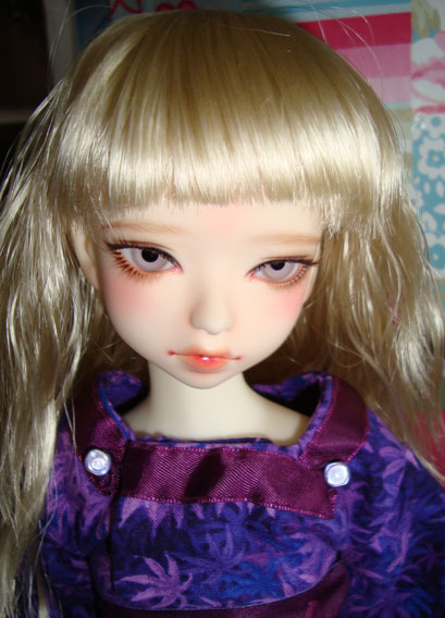

Blank head. She has a heavy pink blushing that can not be seen because of flash
Comparison with an old budle
comparison of resin
On a Volks MSD white skin body

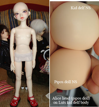

This morning, I have received my kid delf girl body for my Alice Head !! She is incredibly beautiful, more than in my imagination
The skin tone and size of the Kid delf girl body fits perfectly ! If you want a young thin girl style, it's ideal.
Promise, I will share photos of her with you as soon as possible![]()
Kid delf Luts clothes fit very well (of course ^^), but she have a Dollmore outfit at this moment and it fits very well too.
I don't know if all MSD outfits sizes fit Kid delf girl body... I have not find any MSD bodies comparaision pics but Kid delf body girl is thin and have no big breast so, for worse, some MSD clothes would be too large.
I have to select my first photos and I want to make some others standing up, but, this week end, I will try to post my Pipos Alice with Kid dekf girl body (Lily) with his Dollmore outfit![]()
